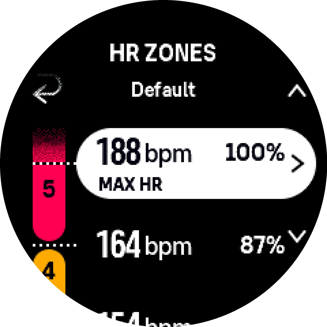

3. Heart Rate Zone
Heart rate gives you a more direct read on the load your body is carrying than pace alone, which makes it a useful reference through a tempo run.
Some training systems place tempo intensity at around 85% to 90% of maximum heart rate, though the exact range varies by system and by individual. Because zone models draw their boundaries differently, defining a tempo run simply as zone 3 or zone 4 is unreliable.
Percentages of maximum heart rate are a general reference, and different zone models produce different training zones. Suunto lets you set heart rate zones from your own data, so you can use real-time heart rate to gauge your intensity through a tempo run.
hr zones of suunto watch

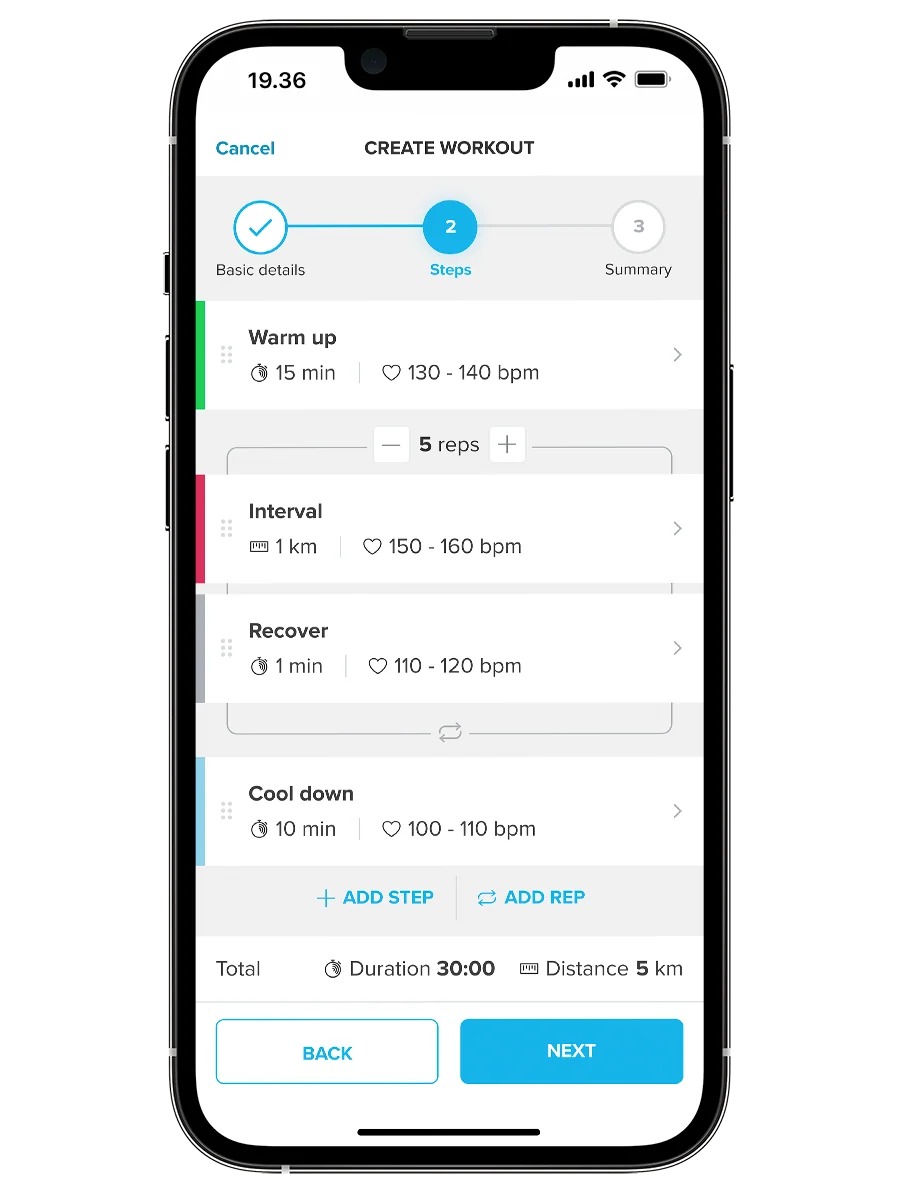

1. Before Running
Create a Workout & Set Target Zones
On Suunto watches that support structured workouts, you can build a session in the Suunto app and sync it to your watch. Some models also let you create simple structured workouts on the watch itself. For example:
  • 15 minutes of warm-up
  • 30 minutes of tempo running with a target heart rate zone
  • Repetitions and workout steps set as needed
  • 10 minutes of cool-down
During the session, your watch guides you through each step and helps you hold your target intensity.
Suunto structured tempo run workout plan

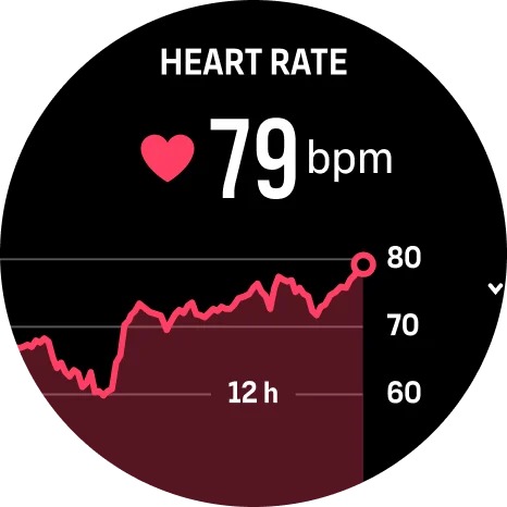

Heart Rate
Check that you are holding your target training zone. It keeps the intensity high enough to create a real stimulus and controlled enough to stay clear of interval territory.

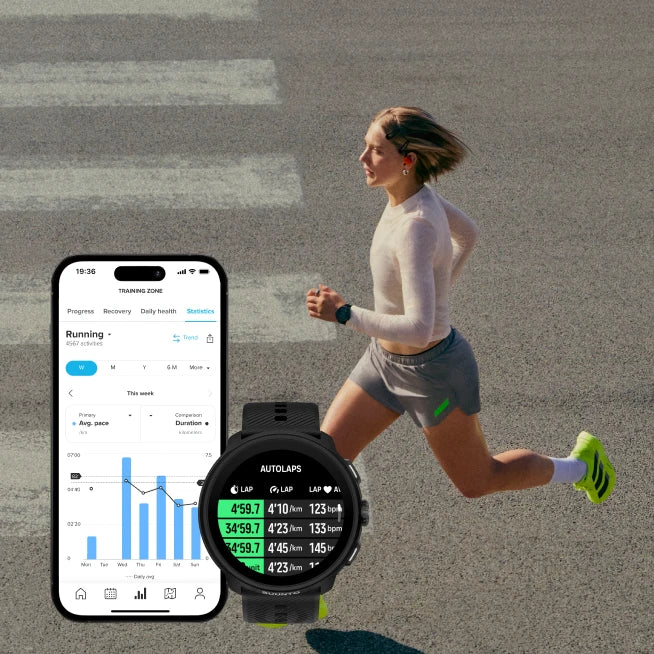

Pace and Distance
Watch that your pace stays steady while the session meets its intended goal. A tempo run is built on consistent effort, so steady pacing matters. The aim is to finish the workout as planned rather than let fatigue cut it short.
check pace and distance in suunto

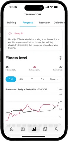

Progress Over Time
Tracking CTL, ATL, TSB, and VO₂ max shows how your training load, training status, and aerobic fitness are moving over time.
The Suunto app and compatible watches let you review long-term training data, including training history and training trends.

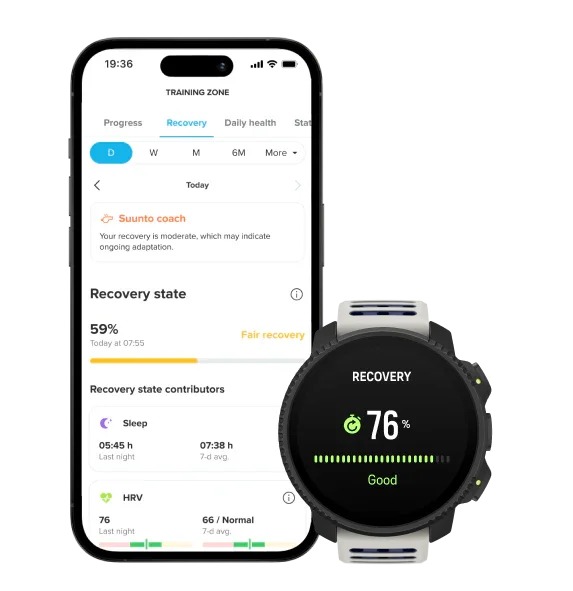

Recovery Needs
Recovery after a tempo run depends on sleep, HRV, training fatigue, and your daily condition. The Suunto app and your watch help you read your recovery status and decide whether to run the next session as planned or ease the intensity and give yourself more time.
recovery widget of suunto
Learn more about Recovery here.
