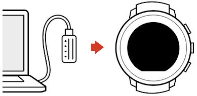

  1. Wake up the device by connecting the USB cable to a PC/Mac or a power source. Use a USB port of 5 Vdc, 0.5A.

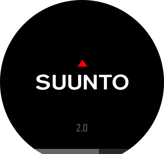

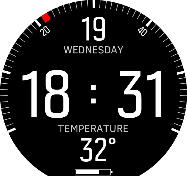

  2. Follow the startup wizard to set up the device. When ready, the device goes to surface state.
    p8-device-ready
    Startup done D5
  3. Fully charge before first dive.
