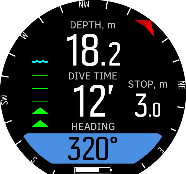

In Air/Nitrox mode, you see the following information in compass view:
airnitrox compass
In the switch window, you see the heading in numeric format.

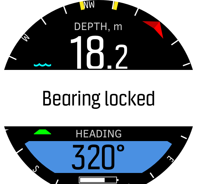

Locking the bearing
A bearing is the angle between north and your target. In simple terms, it is the direction you want to travel. Your heading, on the other hand, is your actual direction of travel.
You can set a bearing lock to help you orientate yourself underwater and ensure you maintain your direction of travel. For example, you can set a bearing lock for the direction to the reef before leaving the boat.
You can reset the bearing lock at any time, but you can only clear a bearing lock while at the surface.
To lock the bearing:
  1. Press the middle button to change to compass view.
  2. Hold your Suunto D5 in level in front of you, with the top pointing in the direction to your target.
  3. Keep the lower button pressed until you see the Bearing locked notification.
    Bearing locked D5

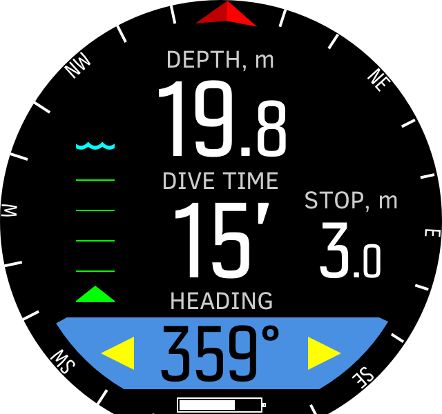

After you locked the bearing, you can see yellow bars to indicate the angle where you locked the bearing:
Bearing Left
When the bearing is at 0°, no arrows are shown beside the value, as above. When the bearing is at 180°, two yellow arrows are shown beside the value:
Bearing both arrows D5
One yellow arrow indicates the direction you need to turn:
Bearing Left
If you want to set a new bearing lock, just repeat the same procedure above. Each bearing lock is recorded in your dive log with a time stamp.
